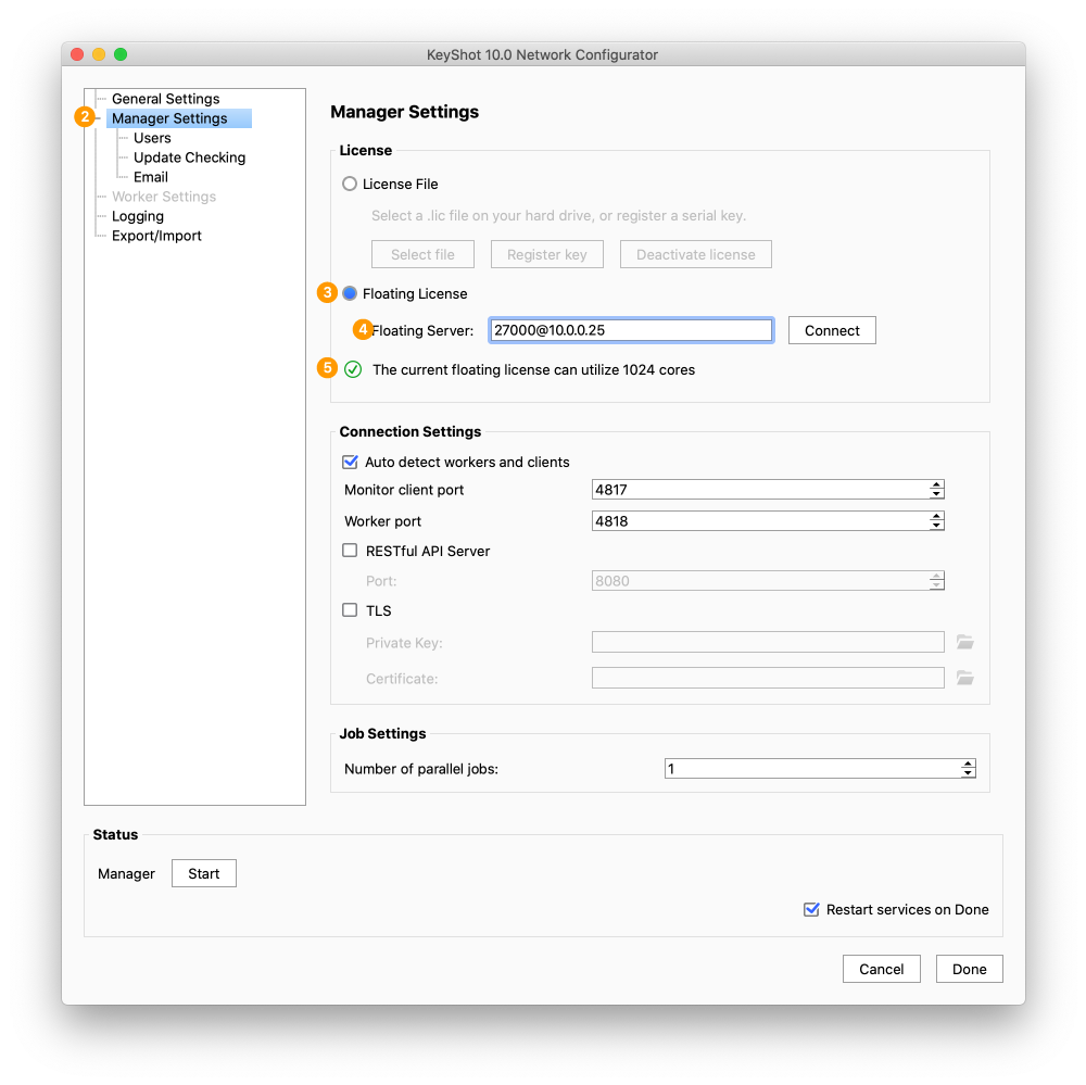

Using Floating License
If you don’t already use KeyShot License Server for your KeyShot licenses you can follow this guide to install the KeyShot License Server.
  1. Launch KeyShot Network Configurator on your Manager.
  2. Go to the Manager Settings.
  3. Select  Floating License in the License section
  4. Enter the hostname or IP Address of your license server. If the server uses another FlexLM port than the standard (27000) you need to specify the port number, followed by the “@” sign and the server’s hostname/IP (e.g. 27000@KeyShotServer.local). Click Connect.
  5. Your license has been installed. The license text shows you how many cores the workers (combined) can use for Network Rendering and when the license will expire. Note that 1 GPU will count as 16 cores.
