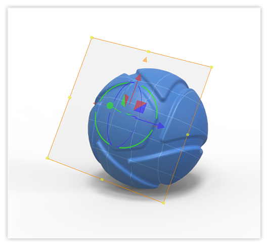

Planar Map as shown in the Move Texture tool.
Planar
The Planar mapping type will project a texture on the X, Y or Z axis. The orientation is set in the Interactive Move Texture tool. Surfaces of 3D models that are not oriented on the chosen axis will show stretching of the texture in the other two axes.

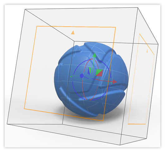

Box Map as shown in the Move Texture Tool.
Box
The Box mapping type will project a texture from six sides of a cube in towards a 3D model. A texture will be projected from a side of the cube until stretching occurs, then the next best projection side will take over. Box mapping is a quick and easy solution that will work in most cases because there will be minimal stretching of textures.

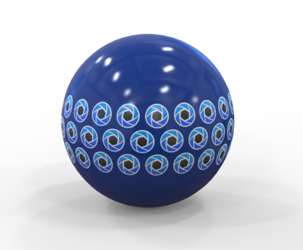

Sphere
The Sphere mapping type will project a texture inwards from a sphere. The texture will resemble the original image the most at the equator. The texture will start to converge as it reaches the poles of the sphere. As with box mapping, stretching is less of an issue when working on multi sided objects than it is with any of the planar mapping modes.

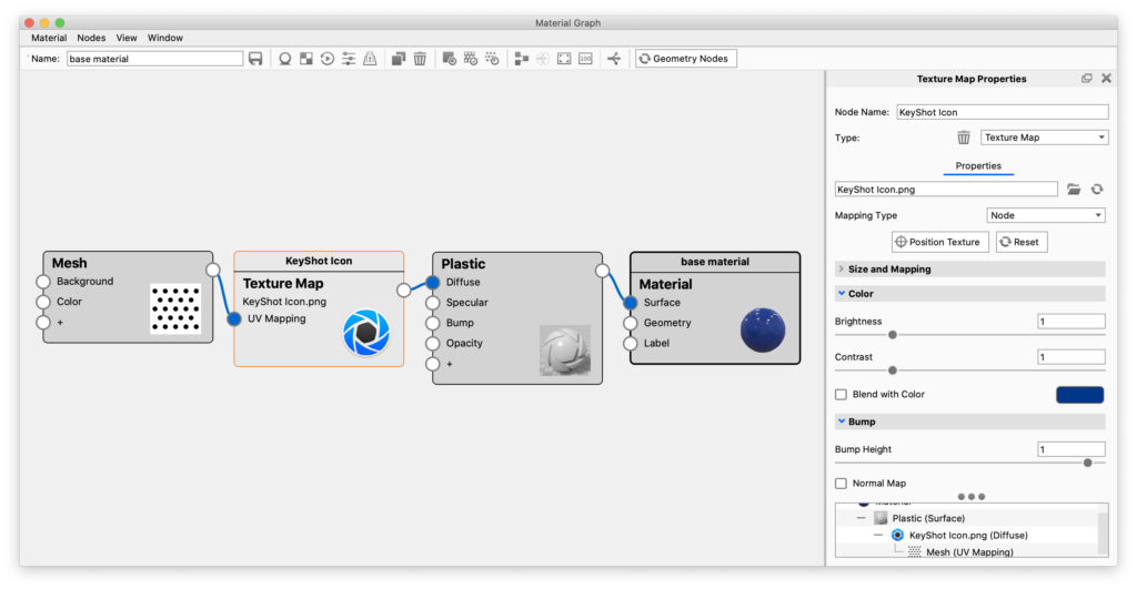

Node
The Node mapping type allows you to drive the mapping of a texture with another node. You can use either a Mesh 2D Texture or Mapping 2D Utility Node as input for the mapping. To use a node for texture mapping, you drag-and-drop the output socket of the node onto the Image Texture or 2D Texture you want to drive and connect it as UV Mapping input to the texture. An example of this can be seen below.
