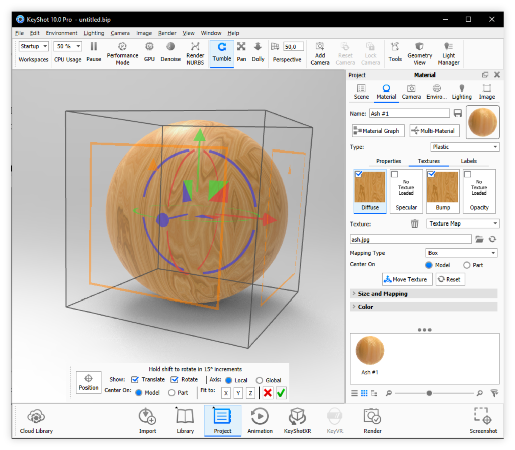

Fine tune the position of textures mapped to your mode with the Move Texture tool. You can access the tool from the texture tab within the material editing menu, and it is available when you are using the Planar, Box, Cylindrical or Spherical mapping modes.
Position
Use this to establish exactly where you want the center of your texture image to project. Once in position mode, you can simply click on the surface of the model to change the where your texture is projecting.
Translate
Use arrow handles to move the texture mapping position on the XYZ axes. To translate the mapping, click on any of the three axis arrows. The red, green and blue arrows correspond to the X, Y and Z axes.
Rotate
Use circle handles to rotate and align the texture mapping to your model. Hold SHIFT to constrain the rotation to 15 degree increments.
Axis
Select if the translation/rotation should use the global or the local axis.
Fit
Fit the texture to match geometry on the X,Y, Z axis.
Center on
  • Model – This will position the texture relative to the model.
  • Part – This will position the texture relative to the part.
Cancel or Confirm Changes
After adjusting the texture mapping with the mapping tool, click the green check mark to confirm the changes and close the mapping tool. Click the red X to cancel the changes and close the mapping tool.

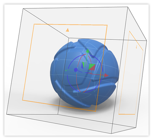

Move texture tool. The Orange squares on the faces of the box are representing the UV coordinates, which can be controlled in the Size and Mapping section.

Moves the texture in the U direction. In the example, the UV plane is shown with the orange box, where the V direction is shown with the small arrow. – this means that in the example Shift U will move the texture sideways.
Shift V
Moves the texture in the V direction. In the example Shift V will move the texture up/down.
Angle UV
This will rotate the UV plane (the orange squares in the example to the right) of the Map
Angle
This will rotate the entire map around the local Y axis. This is the same as rotation in the Move Texture tool and means that the entire box will be rotated around the green axis in the example.
