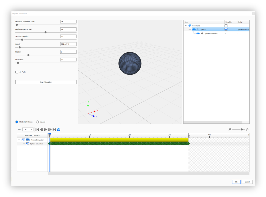

  1. Launch the Physics Simulation tool
    The Physics Simulation tool can be launched either from the Tools Section in the Ribbon, or via right-click on a model or part in the scene tree or Real-time view.
  2. Select a part or model
    In the scene tree list to the right, select which parts or models should be included in the simulation.
  3. Simulation Time
    This allows you to determine how long the simulation is going to last. Note that if your simulation time is 0 the animation will run until everything is settled.
  4. Keyframes per Second
    You can adjust how many Keyframes per second your Keyframe animation should contain.
  5. Simulation Quality
    This allows you to control how many steps per second are calculated. By increasing this your simulation becomes more accurate, but it will also take longer to calculate.
  6. Adjust the Gravity
    You can set your gravity to a value between 0 and 100.
  7. Friction
    Allows you to globally control the static and dynamic friction on all objects.
  8. Bounciness
    Allows you to globally control how bouncy objects are, when colliding with other objects or the ground.
  9. As Parts
    As Parts allows you settle the parts of your model individually.
  10. Begin Simulation/Stop Simulation
    If you have made all the adjustments above, you can click Begin Simulation. You can also stop the simulation clicking the same button.
  11. Animation Timeline
    In the simplified animation timeline you can see and re-run the created Keyframe animations.
  12. OK or Cancel
    To finalize the changes to the scene and close the dialog, click OK. Cancel will revert all changes and exit the dialog.
