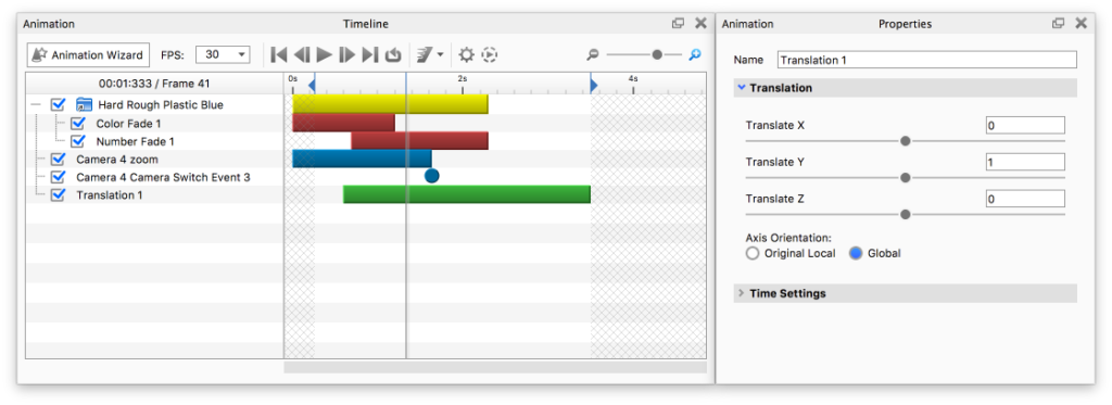

The animation panel consists of 2 elements – the Timeline and the Animation Properties. This can be toggled via the Animation icon animation option in the Toolbar or via the hotkey A.
Animation panel
Animations are represented with nodes in the timeline and labeled according to the name set in the animation properties. When an animation node is clicked in the timeline, the properties will be displayed.
Animations can be shifted in time and scaled interactively to control timing and duration.

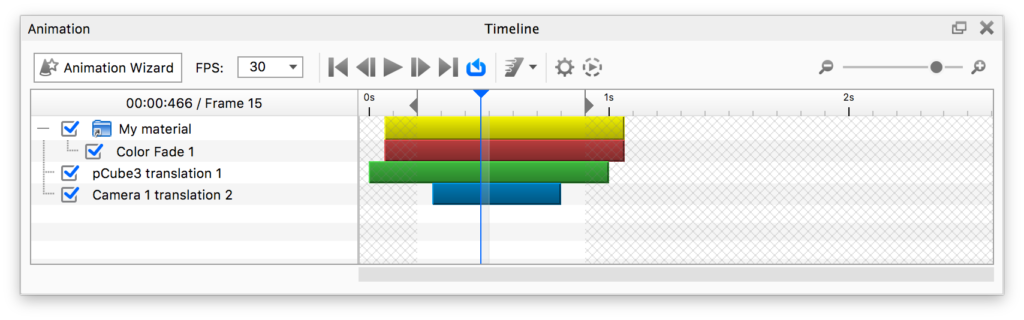

Time Indicator
You can grab and drag the Current time indicator back/forward to the place in the animation you wish to see.
Work Area
The Work Area limits the time span of your animation. With the 2 left/right facing triangle-handles you can limit the Work Area. The Start/End time of the Work Area can also be set by right-clicking in the timeline ruler or in the Render Dialog before you render your animation.

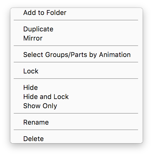

Managing Animation Nodes
Animation management utilities can be found by right-clicking on animation nodes in the animation list. To change the animation order or to move an animation into an existing folder, click and drag the animation. To multi-select animations, hold CTRL (PC) or Command (Mac) while selecting multiple nodes.
Add Folder
Right-click on a blank area in the animation list to display this option.
Duplicate
To duplicate an animation or animations, right-click on the animation(s) you would like to copy and select Duplicate.
Mirror
Right-click on the animation(s) you would like to have a reverse duplicate animation of. This is useful for exploded view animations and for situations where you need to have the animation end where it began, such as for a looping video.
Lock/unlock
This will lock/unlock the current animation node, this means that the animation is still visible but can not be edited. Locked nodes appear with a color a shade lighter that the unlocked nodes.
Hide/show
Deactivates/activates the current node. This is the same as toggling the checkbox in front of the node name.
Hide and lock
Deactivates and locks the current node
Show only
Deactivates all other camera or part animations.
Rename
This will let you rename the current nodewithout going through the properties.
Sort By
This will let you sort your animation list by; NameType or Start Time. If you change the order by drag and drop, the sorting will revert to None.
Delete
Select this option to delete one or more animations from the timeline
Selecting an animation will display its properties on the right side of the Animation panel. These settings are the same used when creating an animation via the Animation Wizard. You may change all existing animation settings as well as the name of the animation in the animation properties. See the Animation Types for detailed descriptions
