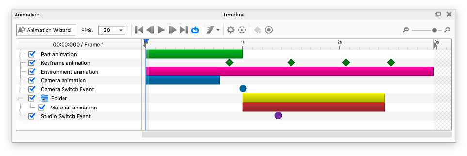

Timeline Appearance
Each animation type will appear with a color in the Animation timeline.
  • Part animation are green.
  • Keyframe animations are green/orange depending on selection state.
  • Environment animations are pink.
  • Camera animations and switch events are blue.
  • Material animations are red.
  • Folders are yellow.
  • Studio Switch Events are Purple.
You can add folders to structure your animations, these are yellow in the timeline.
Furthermore you can import models that contain animations such as Keyframe animations and Deformable meshes. These will appear as purple and orange nodes.

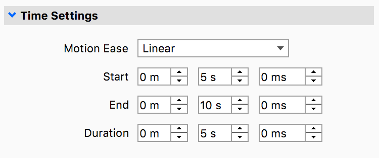

Time Settings
Common for the animation types (except Curve Fade animations*) are the Time Settings, where you can control the timing and duration of your animation.
Motion Ease
Select if you want the add motion ease to the animation – see the Motion Ease types.
Start
Set the start time for the animation
End
Set the end time for the animation
Duration
the duration will automatically be calculated from the Start and End time. Alternatively you can enter the Duration and Start time – This will automatically fill the End time.
*Curve Fade animations have the easing “built in” to the type itself. learn more on the Animation Node Types page.
