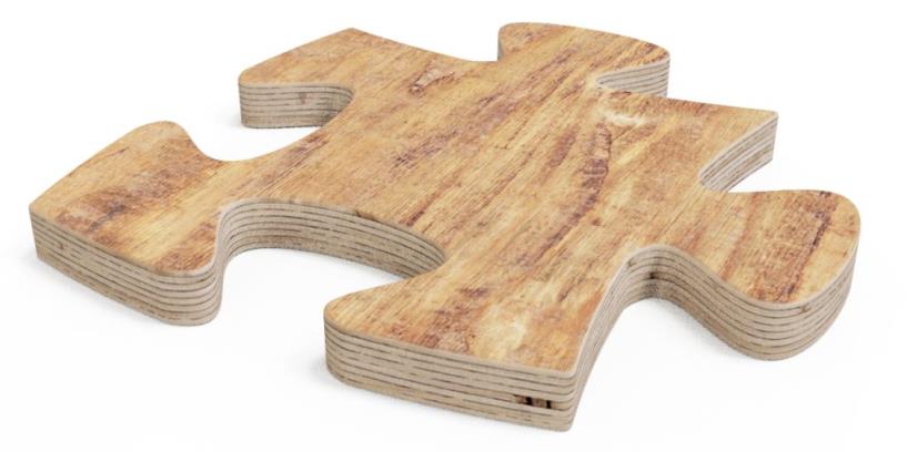

Tri-Planar texture is an type of Image Map. Tri-Planar textures and their settings can be viewed in the Project Window > Materials > Textures tab.
The Tri-Planar texture enables you to create materials that have different textures on the 3 planes of the object – which can be useful when creating such materials as plywood.
This texture type is only available as box mapping, as the essence of the texture type is that it projects a different texture onto each of the X Y Z planes.
