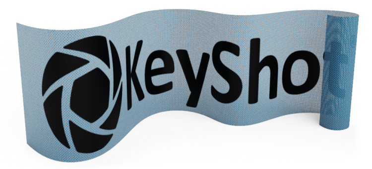

RealCloth material with label on top. The label would have appeared stretched, if it could not be UV mapped to the object.

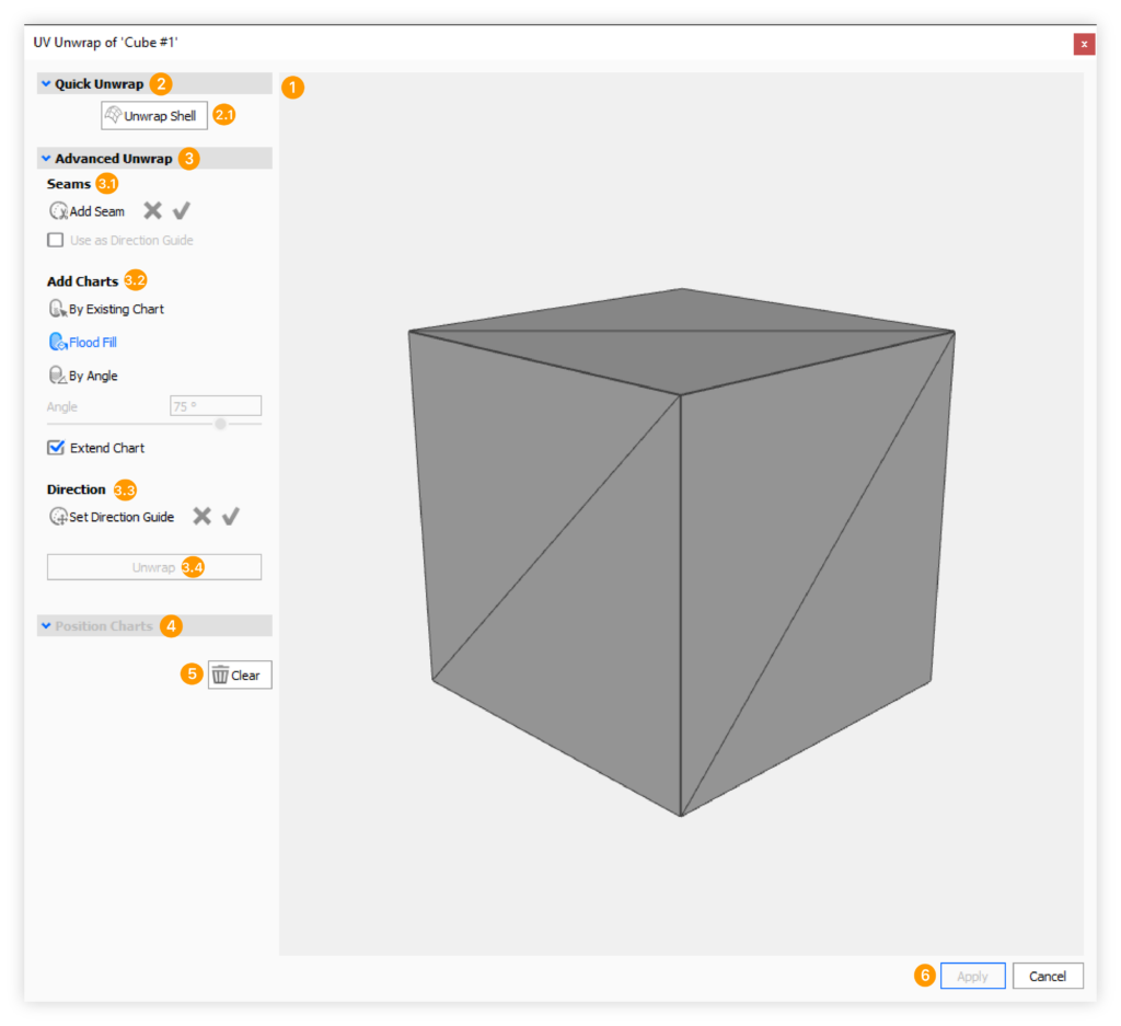

1 Preview: Shows the object that you are going to unwrap. The wireframe shows the geometry’s mesh. The faces of the mesh also act as the base for seams and directions when you are setting up the charts for unwrapping.
2. Quick Unwrap:
2.1 Unwrap Shell: This method can unwrap shells in one click. It is targeted at simple shells, which can contain holes – but will not be able to unwrap sphere geometry (ie. closed objects). For those you will have to use the Advanced Unwrap, where you can specify multiple charts and control where to add seams.
3. Advanced Unwrap: The Advanced Unwrap enables you to create multiple charts, select where you want seams, and also control the U-direction of the UV-coordinates.
3.1 Seams If the geometry is a sphere (closed geometry) or in some instances a cylinder (a surface with holes) UV unwrapping will require you to set one or more seams. This is where Add Seam comes into play.
Add Seam: This enables you to, in the preview, select where you want to have a seam. The seam will be highlighted in red. Enable Use as Direction Guide if you want the U direction of the UV-coordinates to follow the seam. When this is enabled, this type of seam will be highlighted in orange.
Use the buttons to cancel or apply the seam.

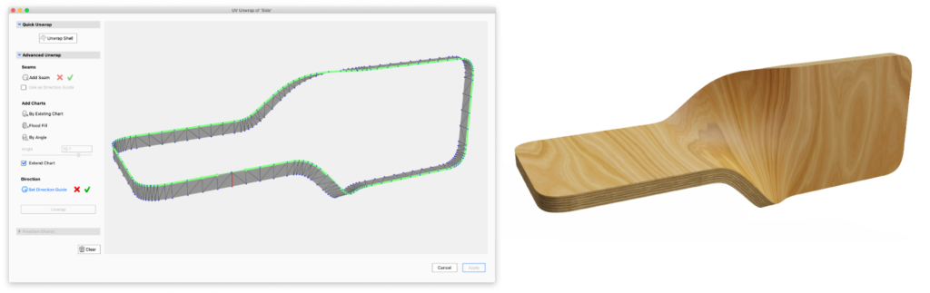

  3. Add Direction Guide: If you want to control the direction of the UVs you can add one or more direction guides. the direction guide enables you to select a line in the geometry that the U direction will follow. The example below shows how the use of a direction guide allows the texture to follow the twisted edge of the plywood.
