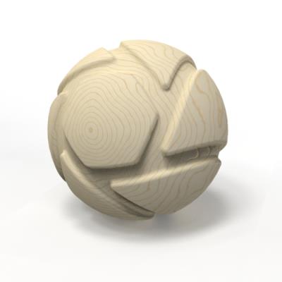

The Wood procedural texture allows you to customize the look of your wood materials. Most often, you will want to start out with the plastic material type and change the specular color to white.
In this example the wood texture is added both as diffuse map and bump map.
