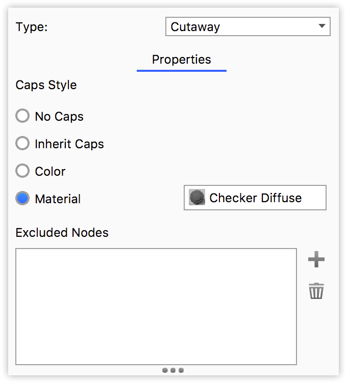

Setting up the Cutaway Material
Simply add the geometry you want to use for the cut, place it so it cuts into your model and assign the cutaway material to it.
Tip
You can import simple geometry (sphere, cube etc.) into your scene from the Main Menu > Edit > Add Geometry.
Cap Types
- No Caps – The cuts will be left open.
- Inherit Caps – The cuts will be capped with the material of the part that is cut into
- Color – The cuts will be capped with a solid color. When this option is selected the cap color will be shown – click the color input to set another color.
- Material – Use another material for the caps. Drag a material from the Library to the material field in the cutaway material properties. Click the material field to edit the material.
Excluded Objects
If you only want to cut into some of the parts of your model you can exclude objects from the cutaway. Click the add button and select the nodes you want to exclude. To remove a part from the exclusion select it in the list and click the
delete button.
