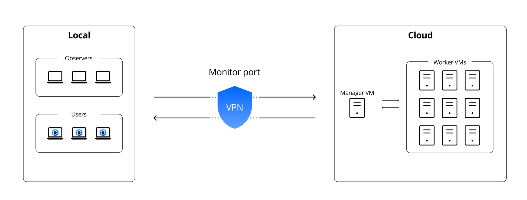

Just like on a local setup you will need a Manager and a few Worker machines, these can be configured as VMs (Virtual Machines) on your Cloud Service.
The Manager machine will control and distribute all data and tasks to the Workers. It will also make all processed results available through the Render Queues.
Aside from receiving the processed results from the Manager, a Render Queue/Client machine would also be the machine to run KeyShot Studio and send jobs to the Manager. We would recommend that your Client machines are actual, physical workstations used by the KeyShot Studio users.

Make sure your Manager has a static IP address/Hostname, so Render Queue and Workers can reconnect after being idle.
Workers
Workers should be isolated behind a firewall and only be accessible via the Manager by the configured Worker-Manager TCP port. Since Worker IDs are created through the MAC addresses, a Worker should be configured with a static MAC address.

Render Queues need to access the Manager via the configured Render Queue-Manager TCP port in order to do any of the following:
  • Send rendering jobs
  • Manipulate rendering jobs
  • See job status
  • Download completed results

It is recommended that you use TLS between the Render Queues and the Manager. Additionally, you can use KeyShot Network Rendering’s user system, which can control permissions and access. Note that if the user system isn’t used, no credentials are required when Render Queues connect to the Manager and all users are seen as anonymous users.
For added security, we advocate for requiring a VPN connection to the Cloud setup such that the Manager isn’t exposed otherwise.
