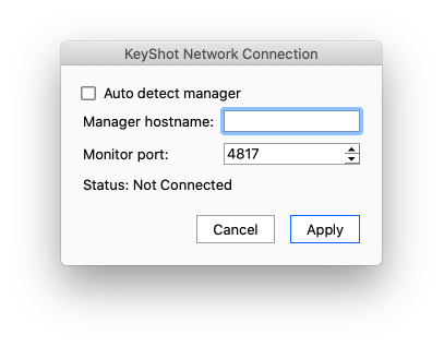

Establish Connection
In the Render Queue under  File > Connection Settings you can specify the connection method.
Auto detect
By default, the connection is set to Auto-Detect and connect to the Manager. When this is enabled, the Render Queue will scan the network to find a manager and connect to it.
Custom connection
if you need to connect to a specific manager, eg. because you have Multiple Managers on the same network. You simply disable auto-detecting of the Manager and enter a Manager hostname and the correct Render Queue port number.
