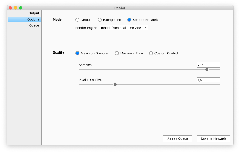

1. Open your scene in KeyShot Studio.
2. Open the Render dialog – It can be launched from the toolbar , via the Main menu > Render > Render or the hotkey Ctrl+P (Windows) or Cmd+P (Mac).
3. In the Options section select Send to Network.
4. Select Render Engine – You can submit jobs to Network Rendering in either CPU or GPU mode. If your computer is capable of rendering both the default choice will be Inherit from Real-time View. Note that some materials/textures are not supported in GPU mode – learn more.
5. Select the the rest of your render settings (visit Render Options for more details) and confirm by clicking the Send to Network button. If there are no workers, using the same Render Engine, connected to the manager you will get a warning letting you know, so you can choose to switch mode or make sure appropriate Workers are made available to the Manager.
