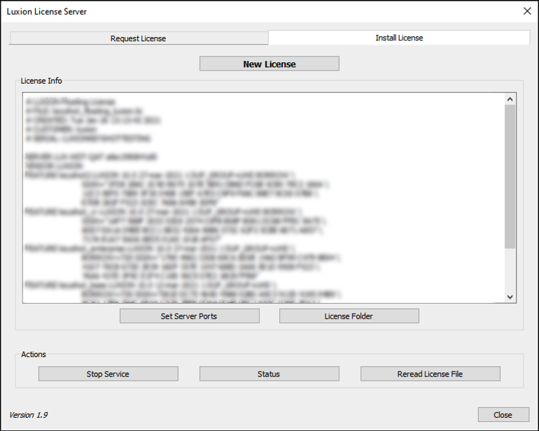

When you get the license file from us, launch the license server and select New License under the Install License tab.
Browse to the License file and select Open
Select Start Service and now users can start using your KeyShot Studio VR licenses.
