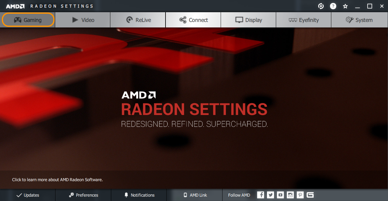

Improving performance with AMD graphics cards
AMD graphics cards will by default match the FPS of the monitor, which may force the headset to run at a lower FPS than desirable. To make the graphics card match the headset’s maximum FPS or exceed it:
  • Right-click on desktop and select the AMD Radeon Settings
  • Go to the "Gaming" Tab
  • Click "Add" in the upper right corner
  • Browse to the KeyShot Studio VR installation folder and ad the KeyVR.exe - Usually located at in one of the following locations:
    • C:\Users\<username>\AppData\Local\KeyVR\bin\KeyVR.exe
    • C:\Program Files\KeyVR\bin\KeyVR.exe
  • After adding the applications Profile in the AMD Radon Settings, edit the KeyShot Studio VR Profile
  • Set "Wait For vertical Refresh" to "Always Off"
  • Restart KeyShot Studio VR
