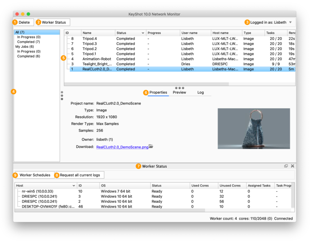

Monitor window
  1. Delete – Delete your render jobs. Administrators may delete any job. Visit the Set up Users page for more information about user privileges.
  2. Worker Status – Show/Hide Worker Status panel (7).
  3. Login account – Displays the logged in user’s name. Visit the Log In/Out page for more information.
  4. Jobs filter – Select My Jobs or All from the sidebar area. You may also filter either of these by jobs that are In Progress or Completed.
  5. Render job queue – Lists all render jobs submitted to the network. Visit the Jobs page for more information about handling jobs.
    For the best performance we recommend clearing the queue regularly. Learn more
  6. Details about the selected job
    • Properties – Displays render job name, type of render, and owner. As well as a small thumbnail of what is rendering/rendered.
    • Preview – Displays image rendering progress.
    • Log – Lists all events related to the job.
  7. Worker Status – Shows connected workers, available/allowed cores per worker, and the assigned regions. Possible status are shown below:
    • Ready – the worker is connected and is ready to render.
    • Updating – currently updating software; not available for rendering.
    • Receiving – currently receiving job data for the task to render.
    • Rendering – currently rendering.
    • Sending Results – sending results back to the manager.
    • Failed – if the worker fails 3 times it will be made inactive, waiting for an admin to take a look at the situation.
  8. Worker Schedules – Show/Hide worker schedules toggle. Worker schedules determine when a worker is active or inactive.
    Visit the Worker Schedules page for more information.
  9. Request all current logs – Download a ZIP file containing logs for all connected workers. You can also right click a worker to access the logs for that specific computer.  Visit the Get Logs page for more information.
