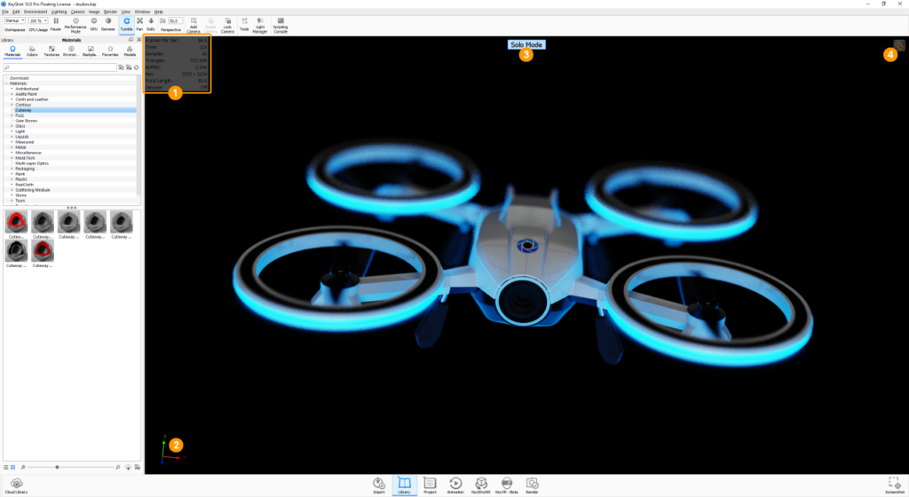

The KeyShot Studio Real-time View is the main viewport in the KeyShot Studio user interface. All real-time rendering of your 3D model will occur here. You can navigate your scene using the camera controls, multi-select objects and right-click directly on your model or in the area around it to view more options.
1. Heads Up Display
For information concerning the Real-time View you can turn on the Heads-Up Display via the Main Menu under View > Heads-Up Display.
The Heads-Up Display will be located in the top left corner of the Real-time View. It shows

2. Coordinate Legend
To help orientate in the Real-time View you can turn on the Coordinate Legend. This will show the X,Y and Z axis of the current view. Turn on the Coordinate Legend via the Main Menu under View > Coordinate Legend.
3. Solo Mode Indicator
This indicator will appear whenever you are in Solo mode.
4. In-view Indicators
Under some circumstances in-view indicators will be displayed in the top right corner of the Real-time View.
