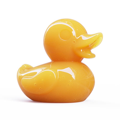

Bubbles in mango juice

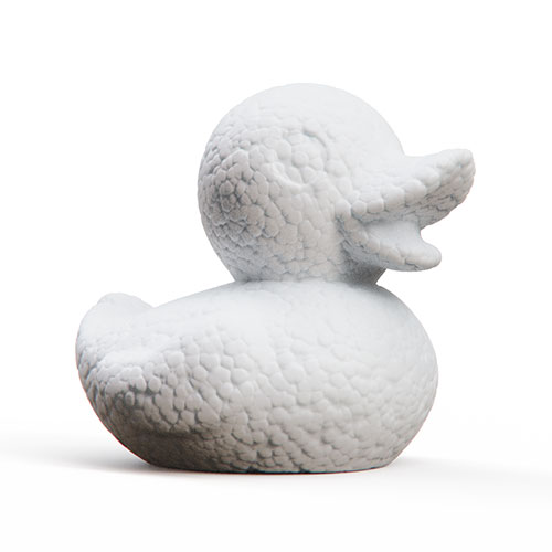

Styrofoam displacement

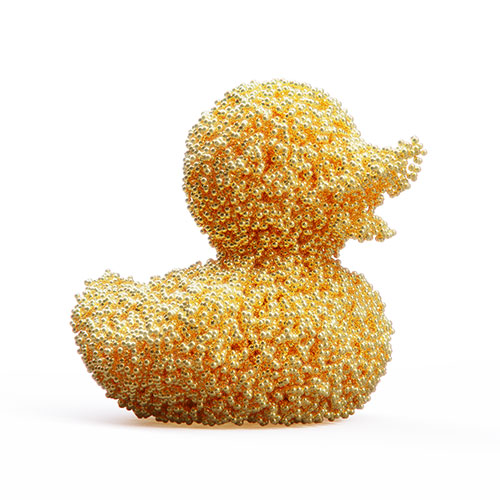

Gold sprinkle flakes

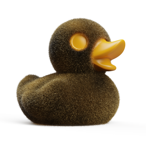

Fuzz applied to the same model
