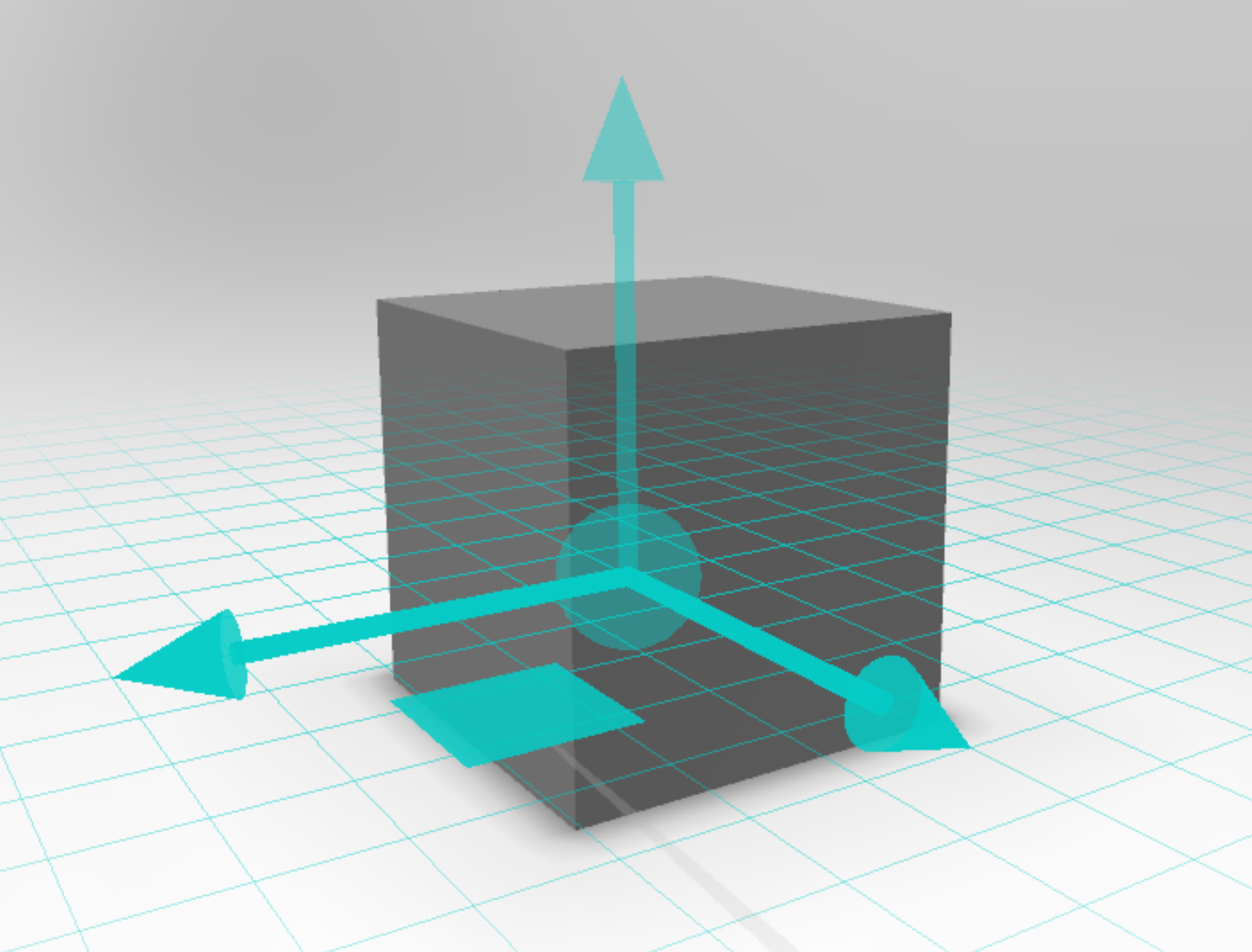

Precise Move Objects
When you aim at an object and trigger the Precise Move Tool a grid and move gizmo will appear. Now you can move the object by dragging on of the handles in the gizmo. By default the X-Z plane will be highlighted with a grid and have a little square handle that will enable you to move freely on that plane. You switch between planes (X-Z, X-Y and Y-Z) by pointing the controller to the central sphere in the gizmo and clicking the trigger button.
If Snapping is active, the object will move in increments that matches the grid. The grid units and scale can be adjusted via the Desktop UI.

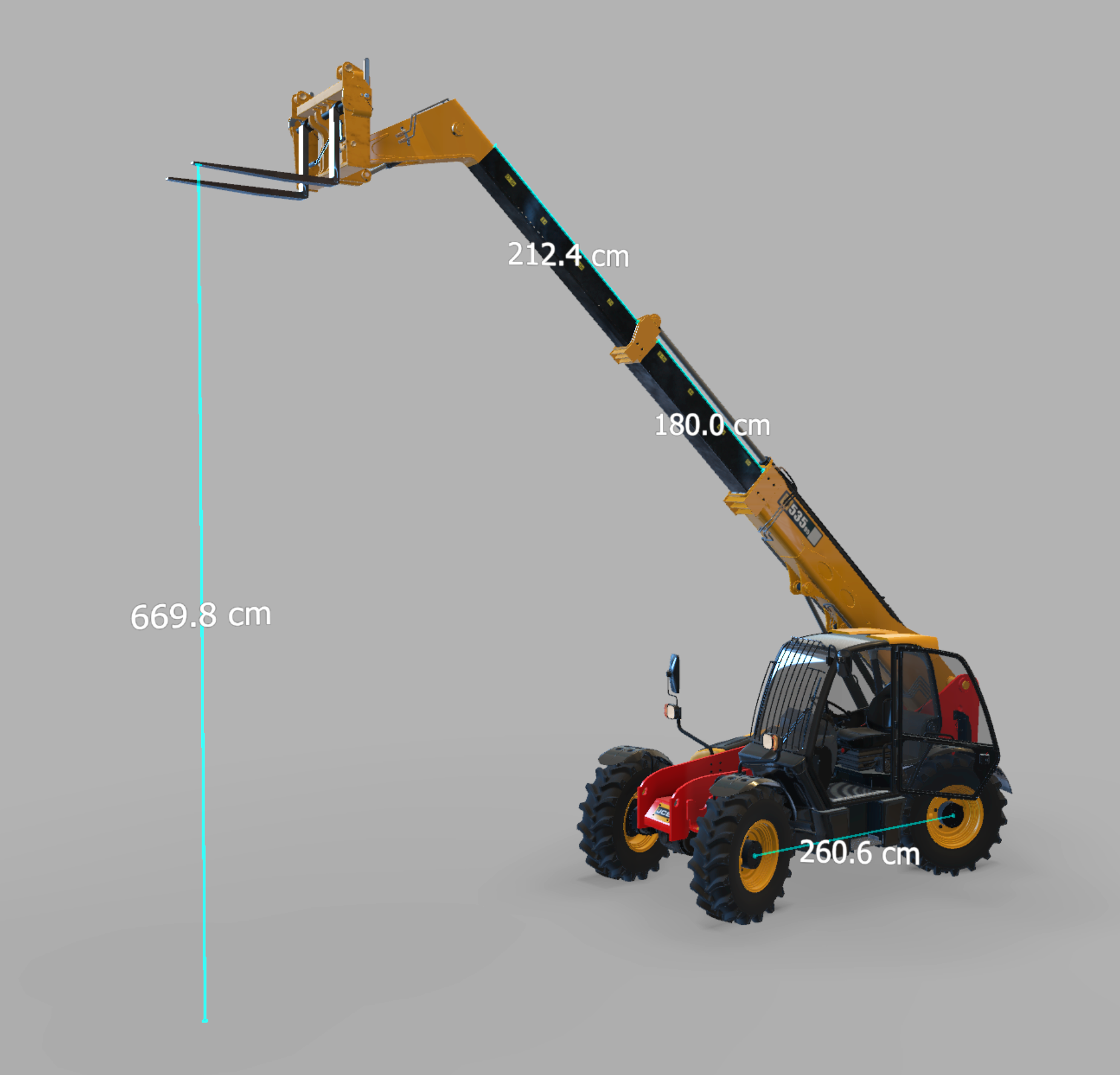

Measure
This enables you to measure anything in the scene. Point at one end of what you want to measure and press the trigger. Now point to the end of the object and press the trigger again to finalize the measurement. Now the line is consolidated and a label will tell you the length.
You can also switch to another tool after the first point is selected, enabling you to eg. fly or teleport and then switch back to the measure mode, to finalize the measurement.
The measurement is made in the Units selected in the Desktop UI.
If Snapping is enabled this also applies to the measure tool. When it is active, there will be guides in the XYZ axis, that you can snap to, and that way secure that the measurement is made in the desired direction.
Snapping can be toggled on/off in both the VR menu and in the Desktop UI.
