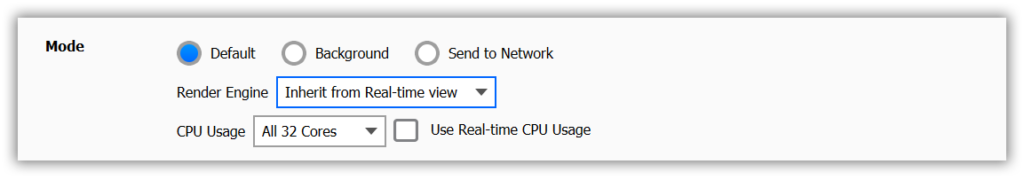

CPU/GPU Usage
Depending on Render Engine selection you can control CPU/GPU usage, which enables you to limit how many cores of your CPU/which GPUs are allocated for the render job.

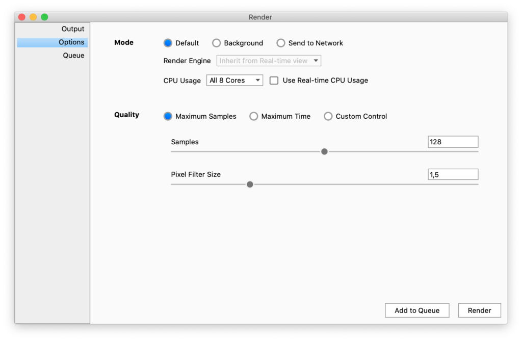

Maximum Samples
The Maximum Samples option controls how many times the image or animation frame will be calculated and refined. Each additional sample will further smooth out noise/grain in the image. This option uses the same rendering technique as you see when working in the Real-time View. (This technique is also used in Maximum Time option, but differs from the method used in Custom Control option.)

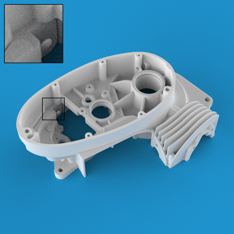

Samples
This controls how many times each pixel in the rendered image is calculated for increased accuracy. Too low of a value will result in an image that has excessive noise. Increasing samples will reduce the noise, however, increasing this setting too high will increase render times without a noticeable difference in quality.
Maximum Samples = 32
Maximum Samples = 128
Maximum Samples = 512
How many samples should I use?
Generally speaking, a simple scene will require fewer samples and a scene with more complex lighting and materials will require more samples. Start low and increase the samples if you still see noise or the render looks grainy. Before rendering out an animation using Maximum Samples, test your samples with a still image render first. You can also set a Render Region on the Real-time View, focusing on the area, you think will require the most samples to look satisfactory. Turn on the Heads-Up Display (H hotkey) and let the Real-time View sit until the region looks that way you like it. Make a note of the number of samples from the HUD and use that info when setting the Max Samples.

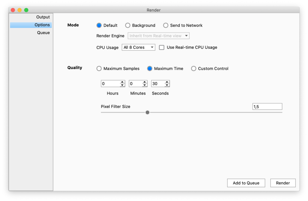

Maximum Time
The Maximum Time option for render quality will progressively refine the render for the amount of time set. This option uses the same rendering technique as what you see in the Real-time View. This technique is also used in Maximum Samples option, but differs from the method used in Custom Control option.
When rendering an animation, you may set the maximum time for each frame to render, or set a total duration for the entire animation.

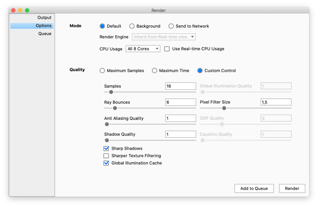

Custom Control
The Custom Control option allows control over all quality settings available in KeyShot Studio. This mode typically produces smoother results in areas of high noise or shadow.
The example below shows a Custom Control rendering with a blue plastic material. Custom Control can be a good option for efficiently rendering noise-free images of scenes with diffuse materials like plastics.
The model in this scene was created by dk and downloaded from GrabCAD
Samples
This will control the amount of rays per pixel that will be sent into the environment to gather information to determine that pixel’s final shade. It is best to control this setting per material and set a value between 8 and 16 in the render settings.

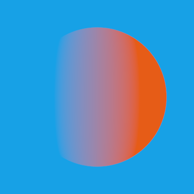

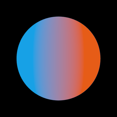

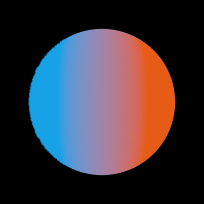

Increasing the anti aliasing quality can help to avoid artifacts that may occur when rendering with alpha (transparency) with objects having a very similar color to the background. For illustration, a synthetic example will be used.
Still Image rendering of a Flat material sphere with a Color Gradient texture whose color matches the background on one side
Transparent rendering on a solid black background color for an Anti Aliasing quality of 1
Transparent rendering on a solid black background color for an Anti Aliasing quality of 5
When the Anti Aliasing value is 1 the blue side of the sphere shows artifacts. These artifacts are absent when an Anti Aliasing quality of 5 is used.

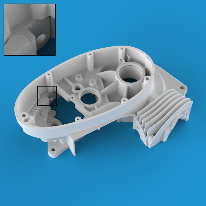

Shadow Quality

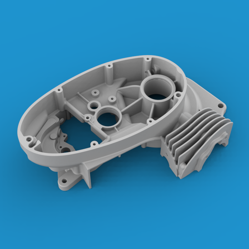

Shadow quality will control the shadow quality for ground and object shadows. Note that increasing Shadow Quality dramatically increases render time. This setting will have most effect for bright diffuse materials, like for example white plastics.
Shadow Quality = 1
Shadow Quality = 3

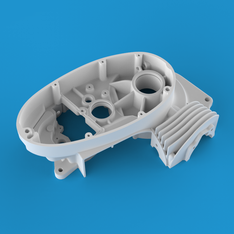

Global Illumination Quality
This will control the quality of all indirect light. Increasing this value can dramatically increase render time. It is rarely necessary to set a value above the default value of 1. If Global Illumination is turned off, this parameter will be grayed out. Global Illumination is enabled/disabled in the Lighting tap of the Project panel.
Global Illumination Quality = 1
Global Illumination Quality = 2
Global Illumination Quality = 4

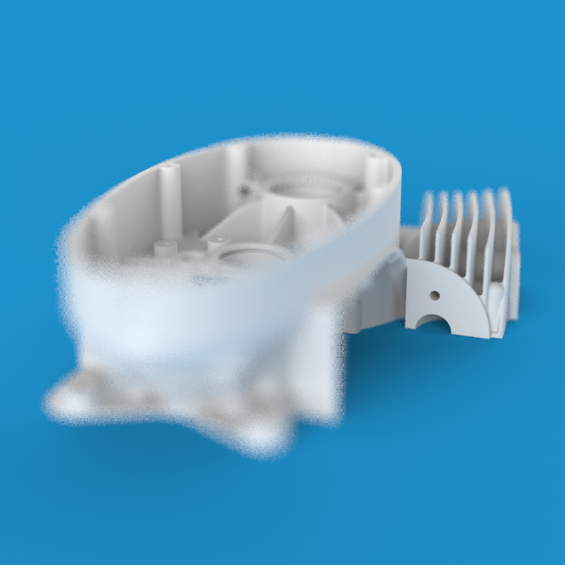

DOF Quality (Depth of Field)
This will control the quality of depth of field if it is enabled in the camera tab. Increasing this value will have an effect on render time. For production quality a value between 3 – 5 is recommended. If Depth of Field is not activated, this parameter will be grayed out. Please see the section on cameras for more information on depth of field.
DOF Quality = 1
One the left side of the slider the DOF Quality=1. On the right side of the slider the DOF Quality=3

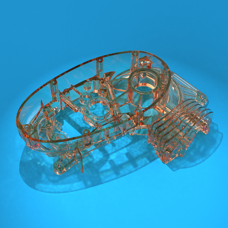

Increasing this value will improve the samples and quality of the caustics. If caustics are not enabled, this parameter will be grayed out. You can enable caustics in the Lighting tab of the Project Panel. The maximum value that can be entered is 50. Increasing the value will increase memory consumption, and high values will require a lot of system memory. Please see the Refractive Index page for more information about caustics.

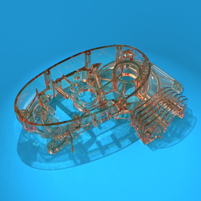

The examples below show the effect of increasing the Caustics quality for a scene with a Solid Glass material, lit by a Spotlight.
Caustics Quality = 1
Caustics Quality = 10
Caustics Quality = 25

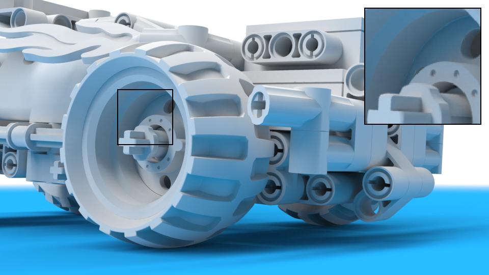

Sharper Texture Filtering
This will attempt to preserve detail in textures when viewed at grazing angles. For example, imagine being eye level with a wood table and seeing the wood grain compress together. Detail can get lost in the compressed areas. This setting reduces the loss of detail. This feature can increase render time so enable only when using textures with grazing angles.
